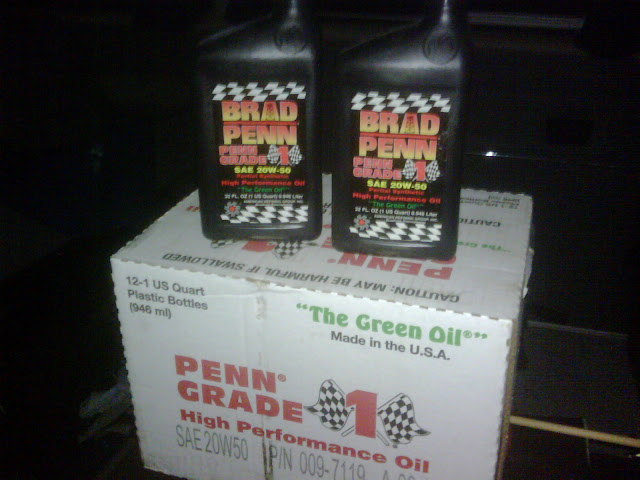

So I'm talking about this controversy at work and my boss who is also my childhood friend is just taking it all in. The next morning this was sitting on my desk....
Then while pointing and laughing at me he reminded me that we wiped about 8 cams in the 2000 modified season before we found out.
So I have $120 bucks worth of the stuff now.
