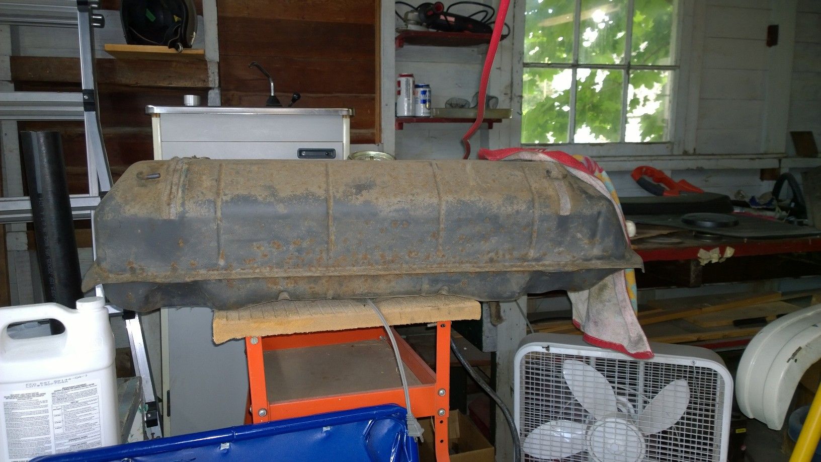

Also should I paint my fuel tank while it's out, or is that little bit of surface rust ok?
If I paint it, how should I wash it to get all the dust off it?
