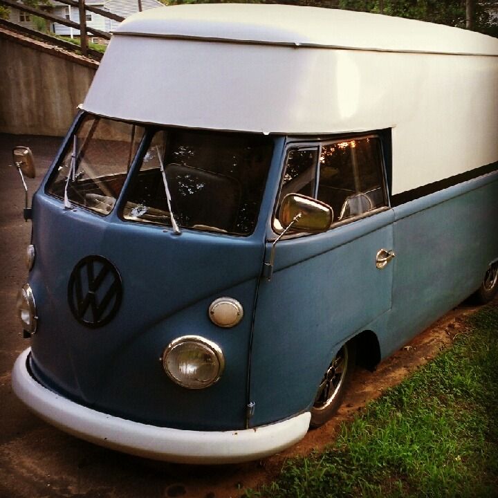

ok so this belongs to a soon to be member of the club. he lives really close to my house in deptford. he needs some help. wants to tag the bus but he wants to raise it back to normal height. fix gas gauge. and something else i cant remember  #banghead. can we do it? its a mail truck from over seas. blew my mind. we can u use my garage to do the work.... even though it wont fit in it.

Looks like the Flying Nun.    You're welcome to use my garage if needed.

Depends on how it was lowered. If its air bags could be major. If its adjusters it might be as easy as jacking it up and adjusting it. Have to figure out if the rear still has the reduction boxes or if it has been modified to standard swing axle or IRS. have to take a look at it

Anthony, thanks for posting the pic of my bus and directing me here.  I was told that the bus could easily be raised back up because the spindles are flipped and the adjusters just need to be raised. Some more important fixes however include;  horn, gas gauge, left headlight and the stick feels loose (but I never drove a vehicle 45 years old).  This is all greek to me, but I'm hoping with your expertise and resources it can be done. I look forward to joining the club and meeting with the members.
