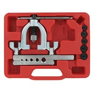

For those of you that are looking to save some money here is a kit similar to what Shawn uses
http://www.tooltopia.com/k-tool-international-70060.aspx
