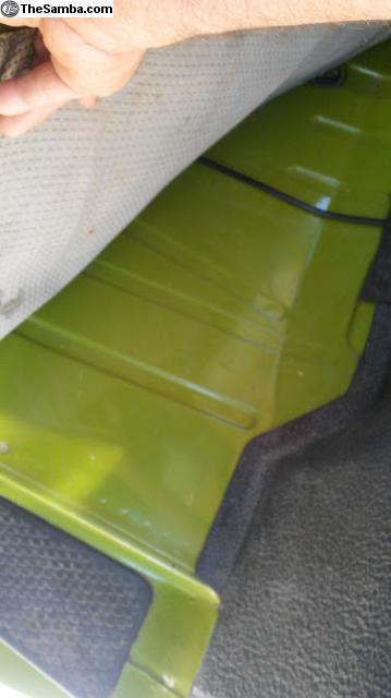

I have quite a bit of work to do... seems like I have been working on this from the ground up.
Still need to put in windows, tent screen, get the doors, strengthn up the frame.... etc...
But I think this baby cannot go out in the rain ?. ever!  not at least with some good layers of paint...

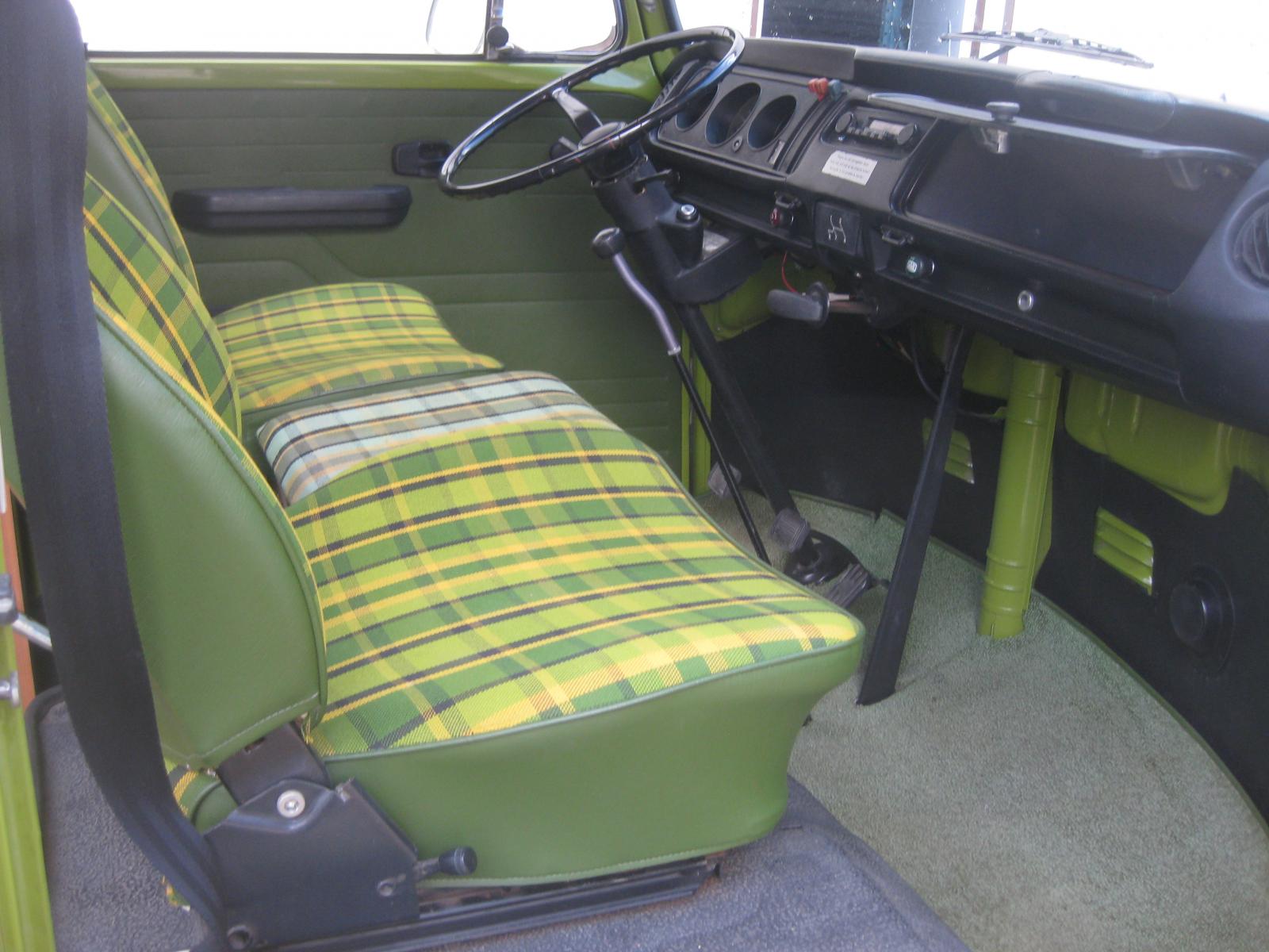

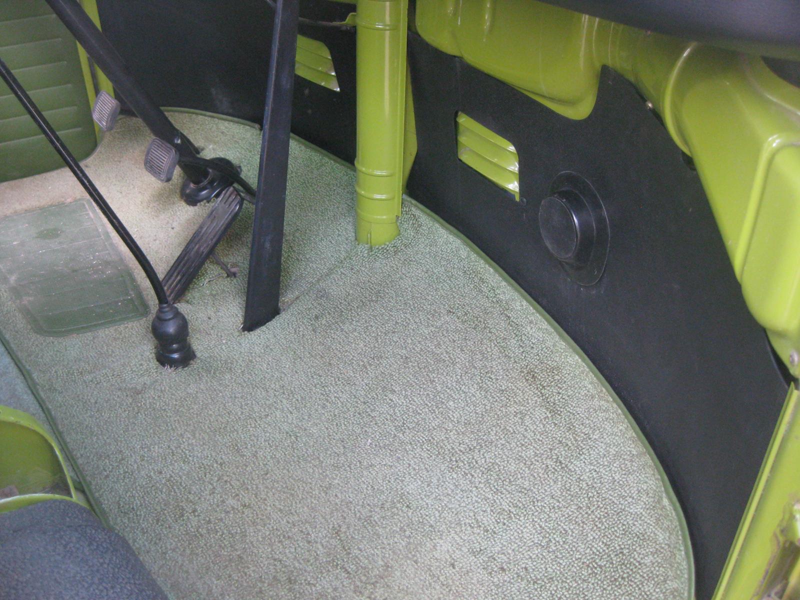

The bus has only  ~57,000  miles on it. The mechanic had  & gave me copies of the original couple's and son's titles which reflect the mileage.  It is pretty much mint except for some surface rust around the rear engine compartment and surface rust around door edges. The rest is solid. It had factory undercoating, which has pretty much mostly flaked off (Obviously they did not use high quality tar  n-o ). Everything that I can tell is original - except the front seat coverings, the mechanic told me they were pretty much discolored so he changed them.  Mechanic said the bus was stored most of its life.  It even had the original label for the sink, still in the sink. Crazy
