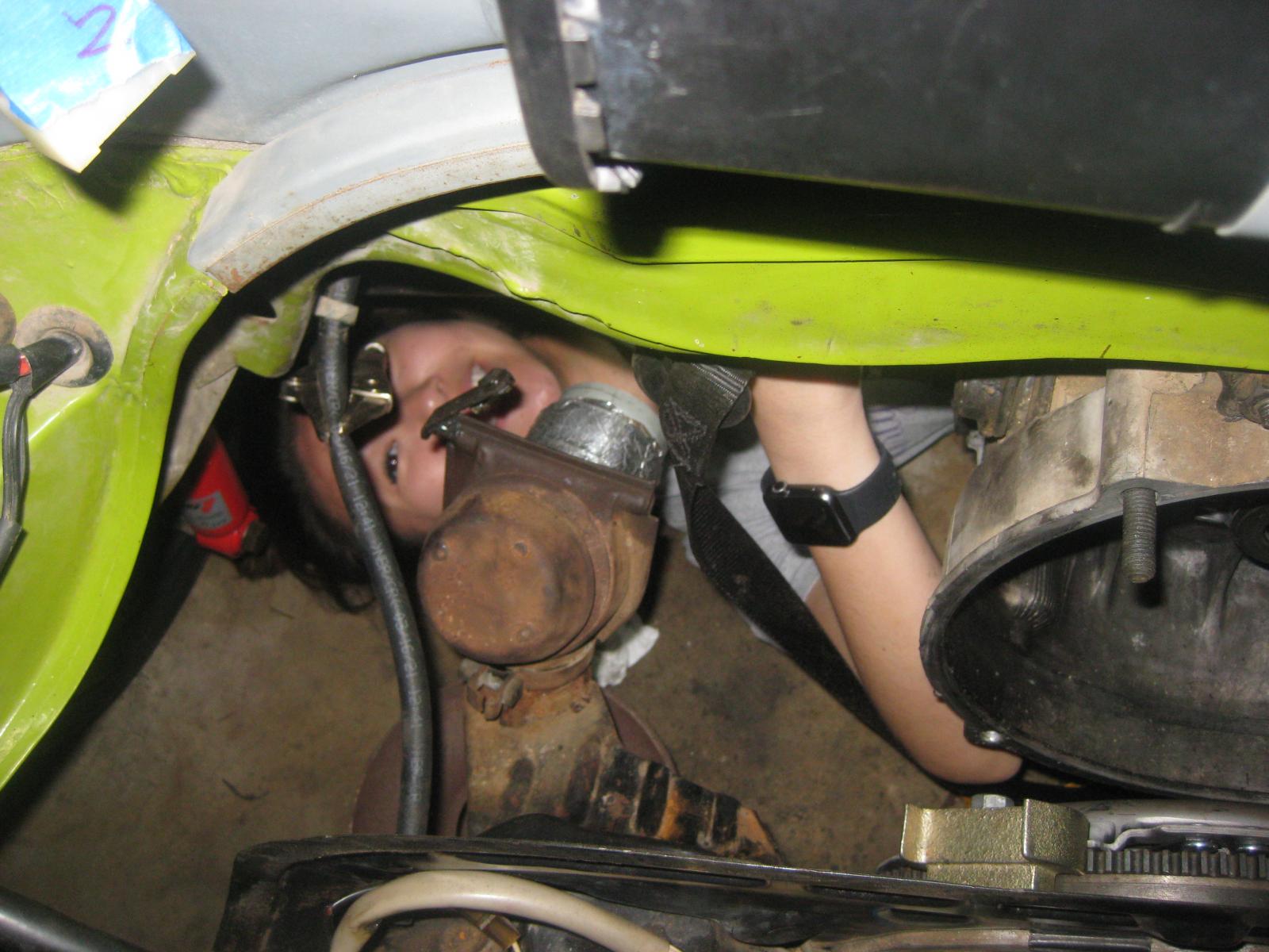

Trying to get it to height level is the issue, between interference with the tops of the heat exchangers and the oil tube, Ted and I in our 9 hour ordeal could not get it level.
I have the engine on a board, on a floor jack. The board is pretty big, covering most of the engine base. On the thesamba I read people have used both, some  just a floor jack ( no board), some with an ATV lift as you mentioned. I bought such a lift, but returned it.  again, I just can't get the engine level because of interference.
At 2 different times once with Ted, once with Katie were able to get the lower studs in, but that was it.  Could not get the engine any higher to make level.
Jack called and suggested to re-align the clutch plate as it being slightly off can be troublesome.  I did check it with one of those plastic alignment tools with the splines, and it was hard to get in one way, but if I  pulled the plastic tool out and turned it a bit it would then  go in easy.  So none-the less Katie and I pulled the engine out. First though we had to bolt the tranny up, as the bus had to be jacked up to get the engine out.
So with the engine lowered complety, and it being rock solid stationary on the board, Katie insisted on being the one to bolt the tranny back in. ( and I it is safe, I made sure)
The board is ~ 1 inch thick large plywood plank. No one is under the car when the engine is being put in ( except maybe me to look at things.  I am very careful to keep her safe, she is a precious treasure to me.

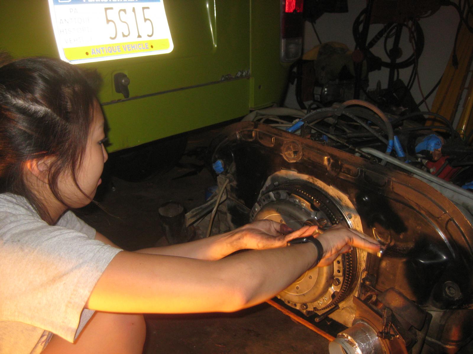

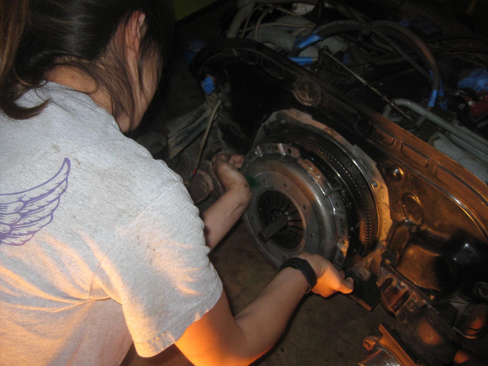

Yes, here in this pic you can see a flywheel lock, I tried to loosen up the plate bolts to align the plate with the engine in the compartment area, but was too much of a prob due to space, and realized  no way I could get a torque wrench on some  bolts later .  So decided to pull the engine out from under the bus.  Here the engine has been let down all the way  & solid, before Katie got under to put the trans bolts back in

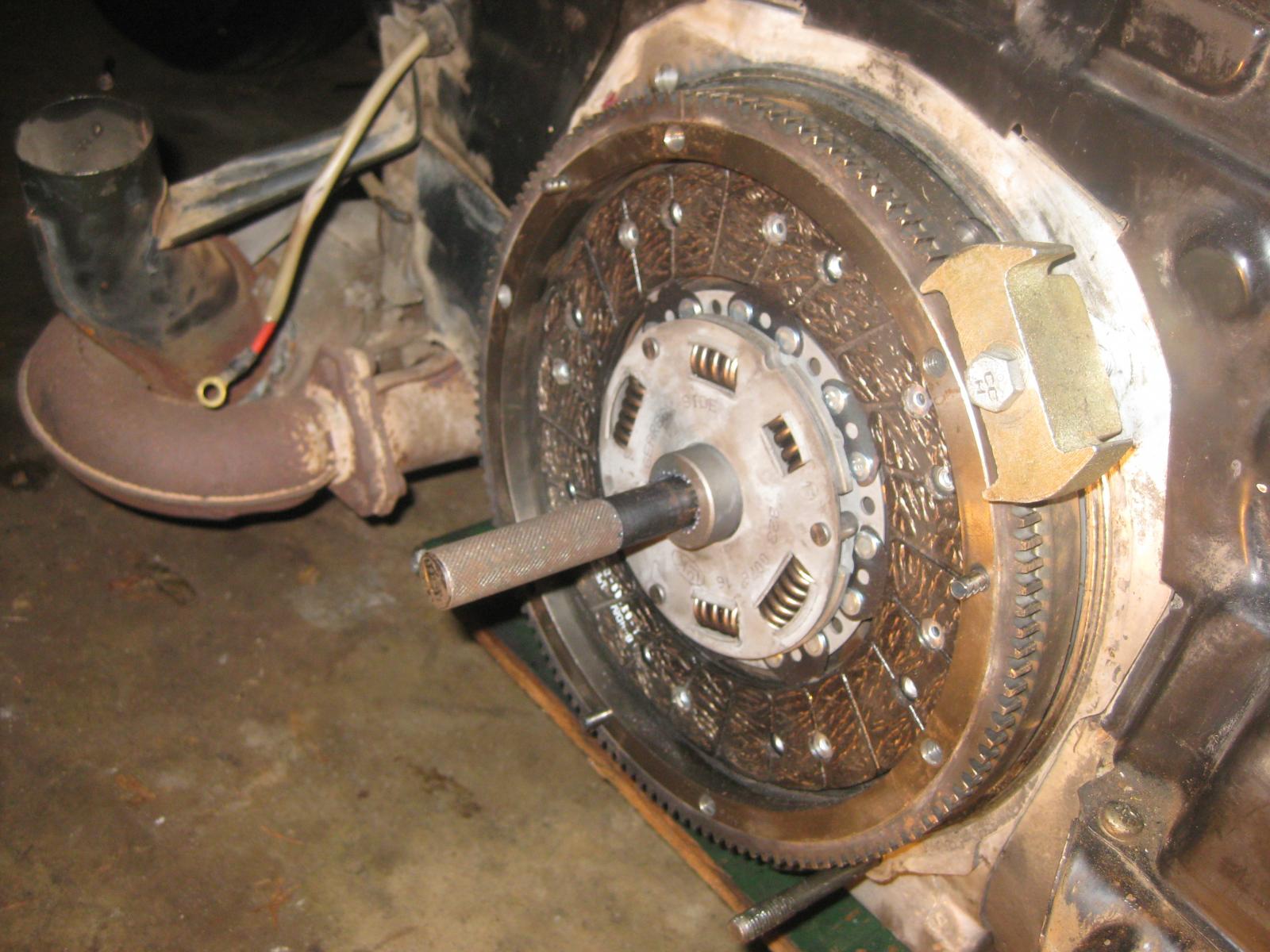

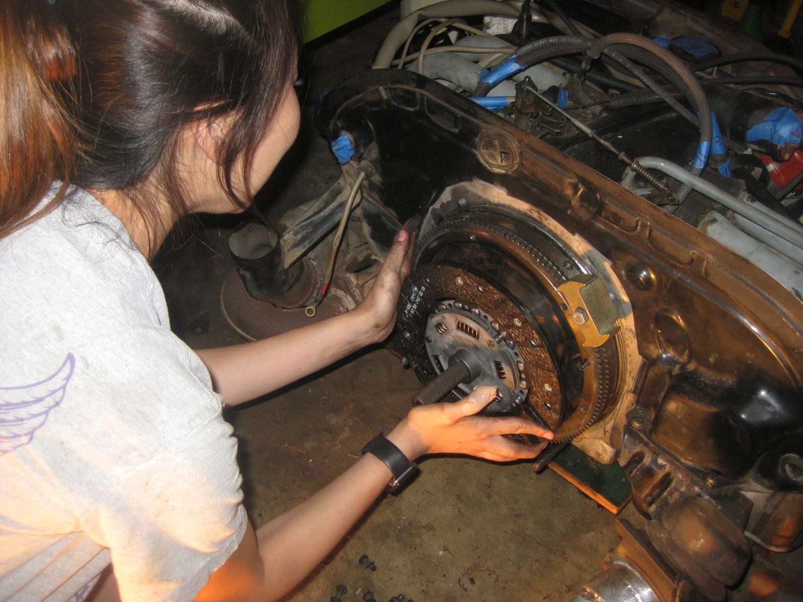

 Instead of the plastic alignment tool, this time I wanted to use my metal alignment tool, - This tool though does not have splines
  -  I used many times for bugs, and never had a prob.

My concern is the alignment tool. It doesn?t need to have splines. I have a 35 year old, store bought tool that is made from wood. But, it must go into the pilot bushing and be rigid when it?s in. The slightest movement and you?ll encounter the problems you?re seeing. The plastic tools that come in the clutch kits work well.

Shawn, thanks,  - the alignment tool is absolutely in the pilot bushing, that was paid very strict attention to, and is tight; no moving around at all.  during install I have not yet come close with the trans drive shaft to begin to go into the clutch plate, last time the  drive shaft was high.  I will raise the bus up a bit, drop the trans again and see if that helps with giving me some room. Today/tonight should be working on it, and if not in, Ted said woefully, he will come over Sat to help.
