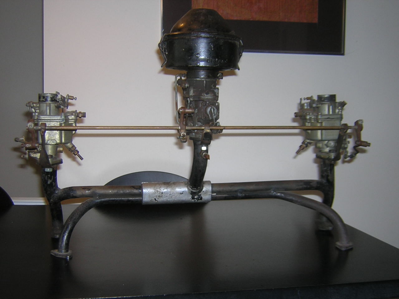

This is my 1st post and I'd like to thank Matt for inviting me to join your site.  First of all thanks for all the comments on my engine and you guys have a very cool site BTW.  It has been a long process in building this engine.  I saw an original Tri-Power back a few years ago at a swap meet and also on The Samba.  It was really weird and cool at the same time and I always wanted one.  Since they were so rare,  even rarer than Judsons, Okrasa's etc;  I knew I'd have an impossible time of locating one so after learning how they were made I decided to make my own.  The center carb is a stock Solex pict with one important differance, it has a air correction jet of  about 220,  so it leans out at a higher rpms.  The 2 side carbs are 24mm Tillotson's,  they do not have accelerator pumps,  do have adjustable jets,  and work only on vacuum.  They are controlled by a semi progressive linkage setup that includes a torsion spring that bends at lower rpm's until the tension is surpassed and then it allows the side carbs to open up.
    The engine runs just like a normal 36hp, but it does have a little better top end then before.   My mileage is at about  28-30 mpg so it has'nt changed much,  as far as performance I can pass on the highway a little faster than before.  Thanks again for all your comments, if you have any questions, let me know.

Hi Nin,
Welcome to the club!
thats a very cool setup, the progressive idea isn't new but I've never seen it done on a vw air cooled engine before. A question, who made it ? and when?
It makes me wonder if something like this couldn't be used on a later engine with carb changes. I know everybody bolts on the Weber / Holly 32/36 progressives but they are such a bad choice and impossible to tune. This setup might allow for more tuning in different rpm ranges, just a thought.

Wecome Nin. GREAT LOOKING ENGINE & CAR. Did you have photos or a diagram to go by when you made it? Very neet pluming job with the fuel tubing.
Quote from: njgt-1 on April 14, 2008, 11:18:20 AM
Hi Nin,
Thx guys,  I had one person tell me a while ago that the Tri-powers were made by some company in the northeast somewhere in the late 50's to early 60's.  They even made some for the later 40hp engines.  Unfortunatly they could not remember what the companies name was.
I'm not too sure if these will work on any other type of engine, since so little is know about them.  It is very hard to get right, especially the timing of the change over to the tillotsons. There was alot of trial and error to get it to run right.
   Here is a pic of an original one that I used to make my tri-power from, the linkage is actually wrong on this pic.  It's the only one picture I have ever seen...  ???
QuoteI'm not too sure if these will work on any other type of engine, since so little is know about them.
I agree with you when it comes to VWs thats the first I've seen. Progressive linkage isn't so rare on other cars, remember the GTO, 3 x 2s with a progressive mechanical linkage. As I mentioned before Corvairs used a type of progressive on the 4 carb Corsa model. I once had a 61 T-bird that used a vacuum activated set of secondarys on a 4bbl carb. I'd think jetting could be trouble but no worse than whats out there. Its an interesting thought and thanks for the photos of your set up, just proves it can be done.
