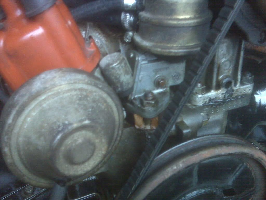

        i went to check my oil and found this,  below the fuel pump this piece is broken.
        She started fine and did not appear to be leaking anything.

the broken piece that broke ,is plastic and it sits about 3 inches below the fuel pump and is about a 1/2 inch thick.
OK Need input...
Year make model displacement.....
little more description... 3 inches below the fuel pump is the oil pump? but no plastic...

ok boys i am out of time i will try again later to post  the picture the base of what i am looking at is very similar to the piece jack posted..   i can not tell you if the neck is on it.  I am guessing that the neck runs up to the fuel pump from inside the stand.
74 super

You have to post your photos to the web. A site like Picasa or PhotoBucket & then link to them in your posts.
Right now I can't think os anything that is 3" below the pump unless your talking about the top of the pump then it would be what I posted.
If it is that and it's not leaking, leave it alone!! But I'll have to see a photo to be sure.

Did ya miss the reply from Jack. @7@  It's a 1/2" thick plastic flange that fits between the fuel pump and the engine case with a hollow shaft that enters the case. You will only see what looks like a 1/2'' spacer between the fuel pump and case when it's mounted on the engine. If you need a new one it's $5.00 and should be thinking about replacing the pump if you're not sure of it's age.
