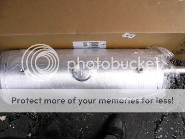

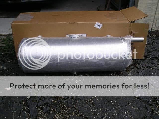

Heres a couple of shots of a custom made gas tank I just got:
No Greg & Baja this isn't a water heater...
heres the top of the tank with the flat area for my gas tank sender and 2 vents..
I was able to order this from http://www.aluminumgastanks.net
these guys make spun aluminum tanks like what you would find on the back of a dune buggy but they also for a very reasonable fee build them to your spec. I got a 10"  x 30" 10 gallon round tank with 2 3/8" vents,a baffel, a place for my gas tank sender ( you have to cut this in yourself) and a side fill tank all for $235.00 delivered. they even include a set of powder coated mounting brackets.
I priced this idea out several ways including custom square tanks and adapting a marine tank from a boat ( that what the car originally had ) this seemed to be the best choice. If you are building a dune buggy, or a Baha or kit car and have a use for something like this drop them an e-mail, ask for a guy named Tim and tell em I sent ya!

So do you have to make a hole in the top for your sender and a 90o elbow for the fill neck?
Re: Gas Tanks - not the stock kind!
« Reply #2 on: August 26, 2009, 04:50:01 pm »
Yep!
all VDO senders don't use the same size bolt pattern, thats why they leave it up to the customer. I have a Triumph spitfire gas cap on the car that has a 90 degree
hose but I'm not sure yet if its staying. I found a couple of nice marine fuel fillers that I'm thinking about just haven't decided yet.

Does the tank have any type of protective coating on the inside ???
To protect it from acidic action   c23
Yuma    ( Sonny )
« Reply #9 on: August 28, 2009, 04:32:49 pm »
Does the tank have any type of protective coating on the inside Huh
Yuma,
its spun aluminum should be safe even with the crappo gas we have today. Same thing you would see on dune buggies or sand rails.

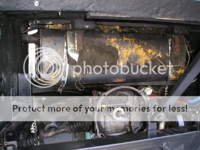

heres what its replacing, this is steel and the inside isn't too bad but I have no idea how long its been in the car..

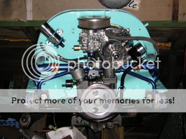

heres one more...got the tins back on the engine & cleaned them up, ain't she purdy !!

« Reply #10 on: August 28, 2009, 04:44:33 pm »
 :icon_eek: :icon_eek: :icon_eek:
No wonder they keep it covered!
 The new one is too pretty to hide

It would be a shame to put that pretty engine next
to a nasty looking gas tank  shocked   rdone
Thanks again   Yuma
« Reply #12 on: August 28, 2009, 09:12:54 pm »
thanks!
but the new one isn't going to show either. I'm building a stainless steel
firewall that will be between the tank & engine. I have the engine separated from the exhaust and the firewall will allow it to pull air from under the car. The idea is to keep it very similar to how a stock beetle setup keeps the hot air from recirculating around the engine compartment. I did this originally and never had a problem with it running hot.
