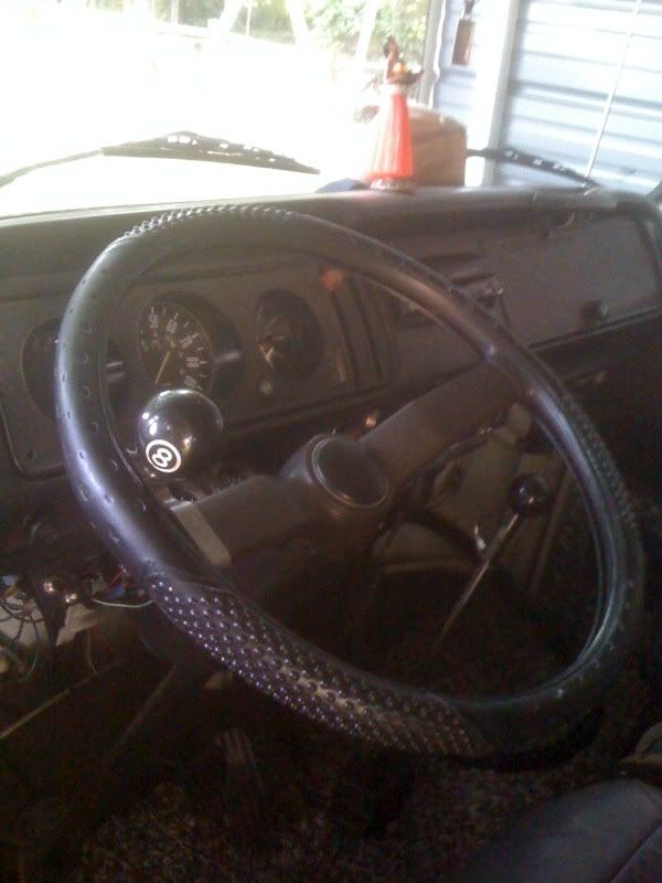

On the way back from Delaware I Stopped at the TA  Truck Stop
on Rt295 to get a 18" Stearing wheel cover for the bus $17.95.
I hate Sticky Stearing Wheels

Damn dude...You know how long it too to get that wheel sticky????
