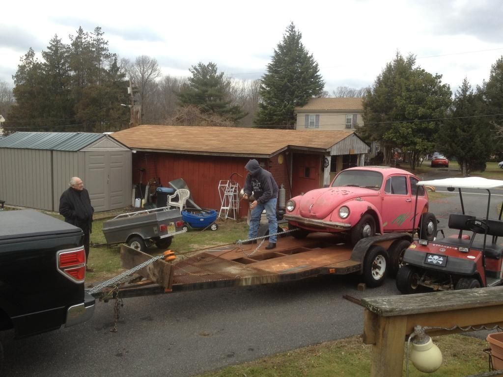

 bawlin)0  Put "Pinky No Clutch" up on the trailer and loaded her up with all the extra Stuff that goes with her. My Brother was in town To help so we Got'er Done.
Now Just have to wait for the Reciving end to say ok and he's RDY.

Golf Cart on the "spares list?"  whistleegi
