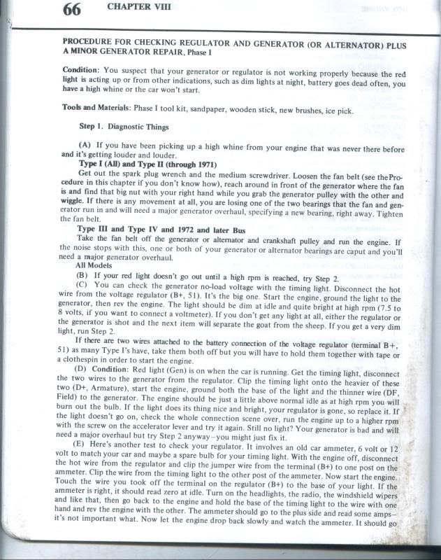

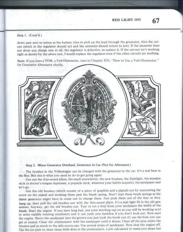

I just went  through this  with my buggy. :wallbash: It sounds like you gen brushes or voltage regulator. Mine was the volt reg.
Here are some pictures out of my how to keep your vw alive book.  This is the bible for  VW's
Hope they help .///
If they are to small  to read use your IE zoom to 200%

Update! Checked the Generator Brushes. They are pretty warn down. I am going to replace them just so I know they are new. I also read in the idiot guide about checking the voltage regulator so I am going to do that too! Question on checking the voltage regulator, do I need a timing light?? or can I just use 2 wires with a light bulb...?? Am I an idiot for even thinking that??
 Not at all. I used a bulb and two wires for years-Just like it shows in the VW Idiot guide, my bible.   :icon_study:
