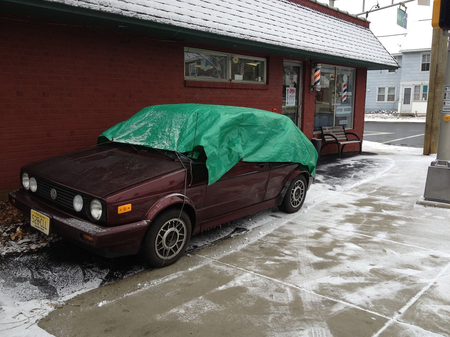

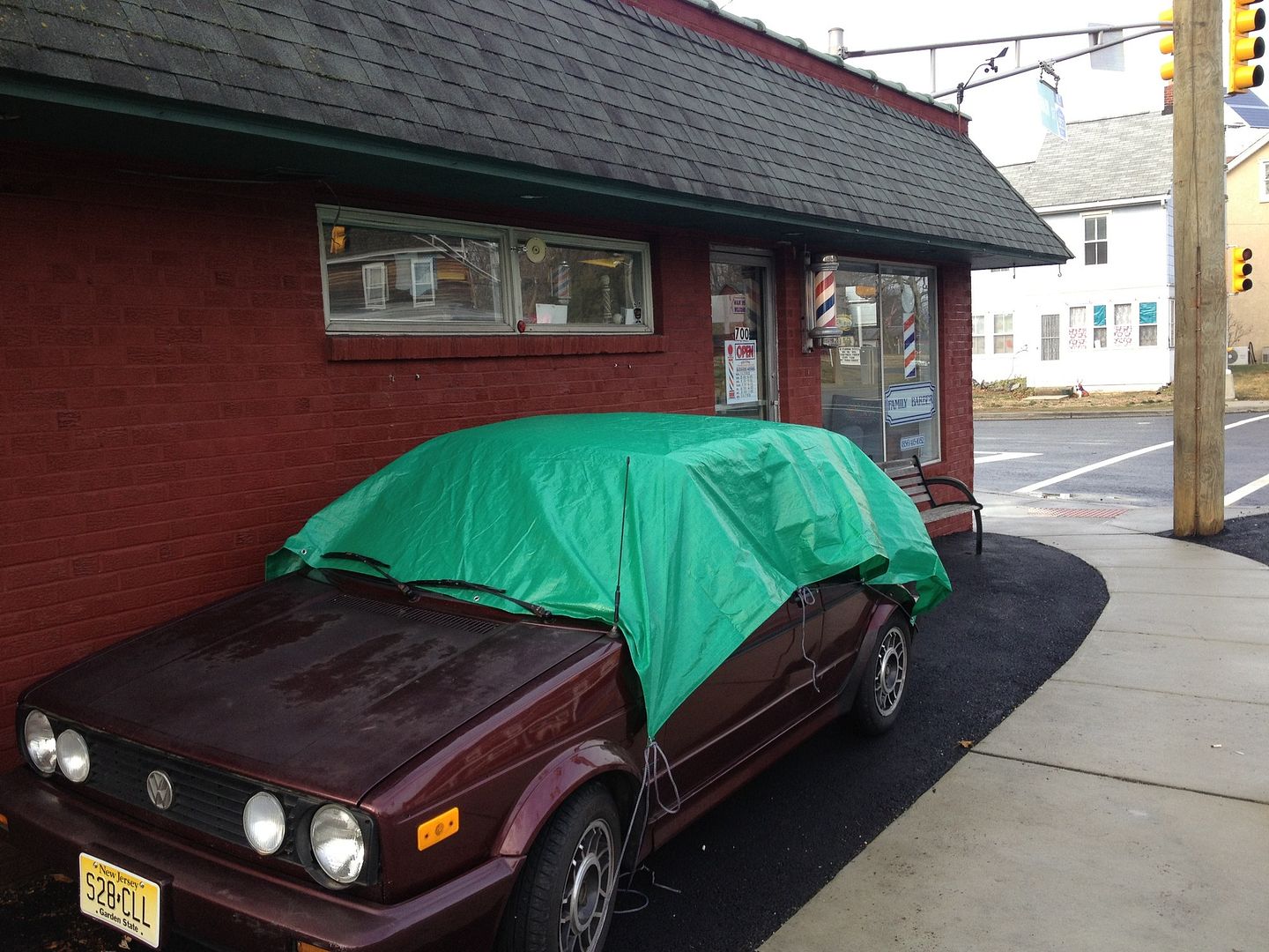

I had to Drive the Cabby to work today.  Didn't want to get water inside with the leaky roof.
That's such a great car. I've always loved Cabrios.
Found out that the rear defroster works in the cabby.  :jump4jo":
