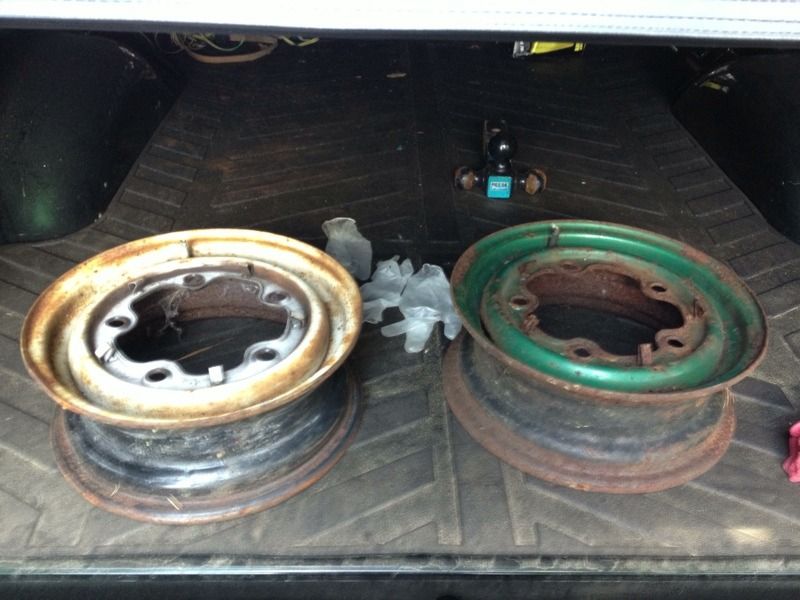

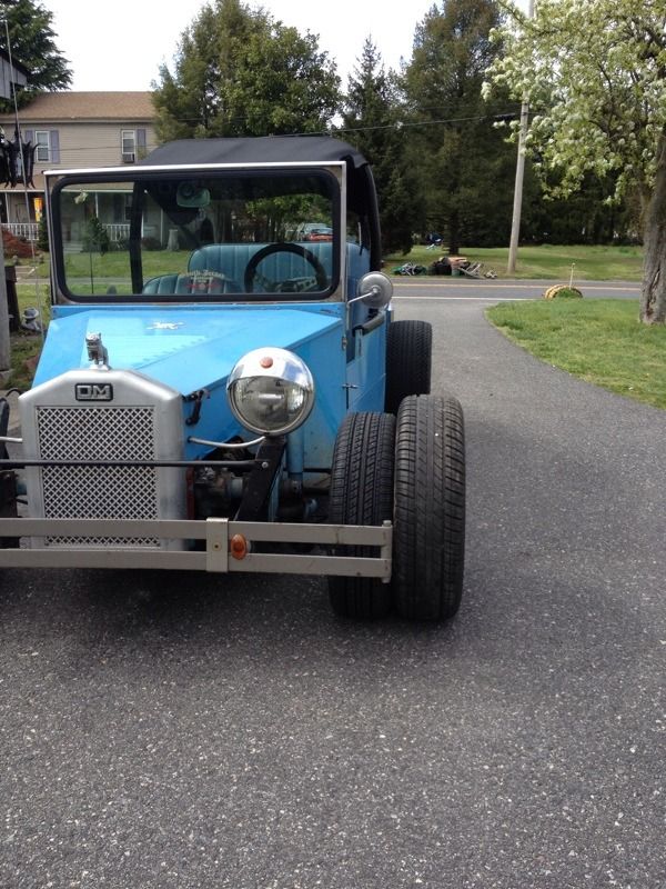

Stoped bye Richies garage today and picked up 2 thing rims.
To bad they look like chit on the buggy. I dont think it has that 40's look with them on.... Looks like I'm going to have to get drop spindles. "darn"

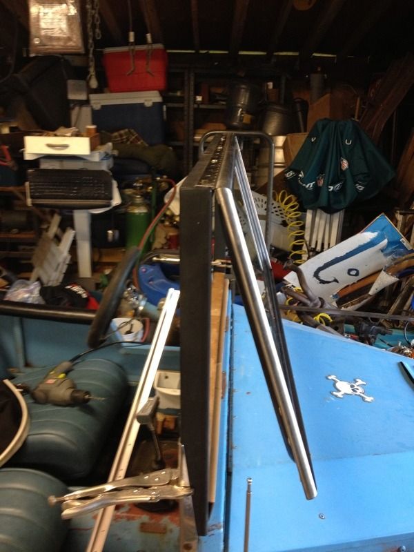

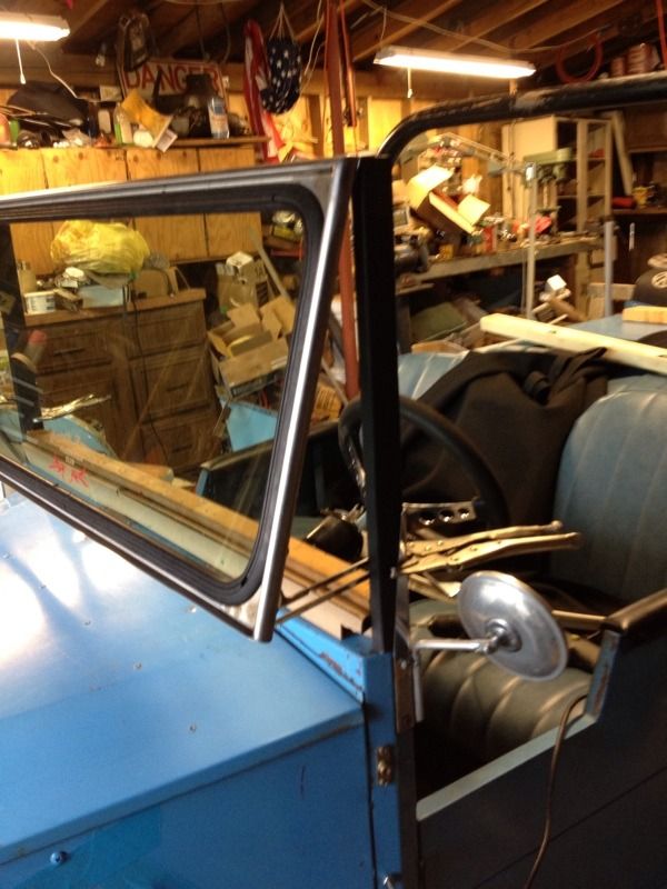

On a side note I mocked up the Window again and installed the hinge to the window and drilled some of the holes for the frame. Have to get some Nuts and Bolts.
