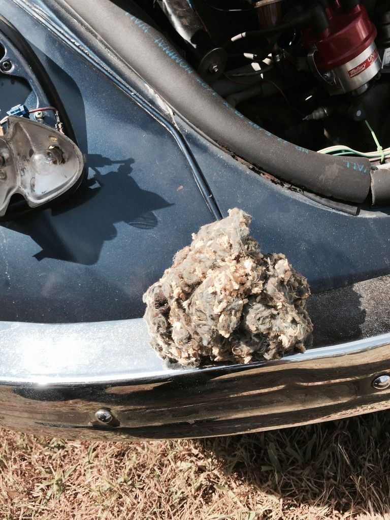

Found a nest behind the drivers side tar board all the way to the back of the seat?

Winter is on its way, put it back when your done working on your lights so the Mice have a warm home.  11&*
