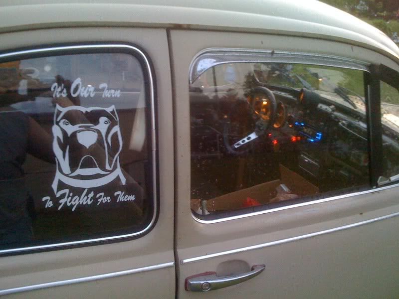

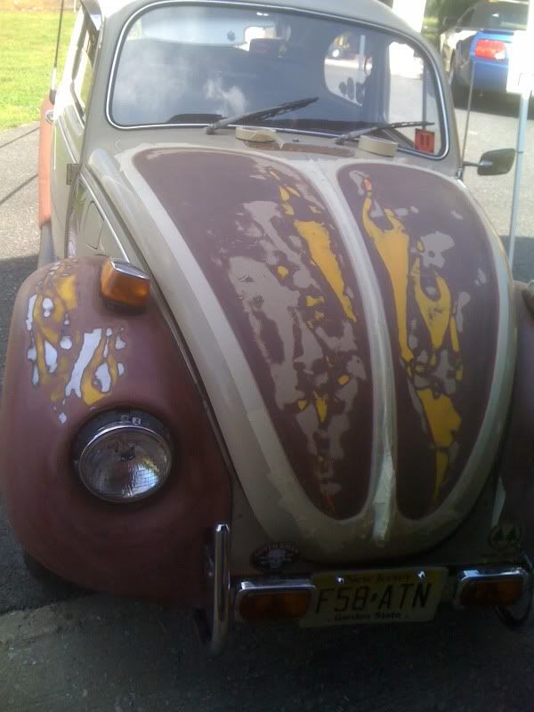

« Reply #1053 on: May 21, 2011, 09:14:46 pm »
Helped Peltzer with his new BUG and made a Sticker for it.

peltzer71
« Reply #1055 on: May 21, 2011, 10:26:28 pm »
 ?/moon2..  Put a fresh coat of Rustolium on the front of the bug! Thanks for helping Glen.  The sticker is awsome.

 2@@cool i like the effect on the hood,  whistleegi just may copy that to TheStrap.
Chris, how did you get the tape job so good on your hood, come and do mine. whistleegi please.

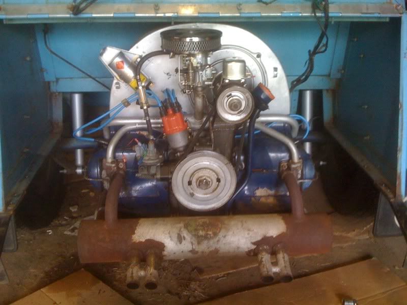

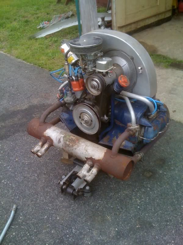

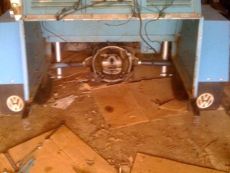

Going to try and get the Empi rdy for the Clayton Memorial Day Parade Mon. May 30.
The 6volt Battery didn't make it throught the winter and I'm not going to buy another.  ?/banghea?/
So it's time to pull the 36'er.
Plenty of room to get the job done.
Came out like a dream didn't even have to jack up the car. **^bana0
Now theres lot's of room there. :jump4jo":
Now I have to find out where to grind the bell housing so the 200mm flywheel will fit. :confused04:;
« Reply #1063 on: May 22, 2011, 03:27:41 pm »
It will rub at the raised part where the bolts go through. Shove the engine in and hang it with one top bolt and turn it to mark it.
Did you get a 6 to 12v starter bushing and starter?
Are you going 12v?
« Reply #1064 on: May 22, 2011, 04:11:36 pm »
Are you going 12v?
Now i'm confused it looks like It has allready been done I think?
Could the 36er have a 200mm fly wheel on it allready? }dunn--
I can't find out how big A 200mm flywheel actually is? &(rage_
Yes I have the bushing and yes going to 12v
