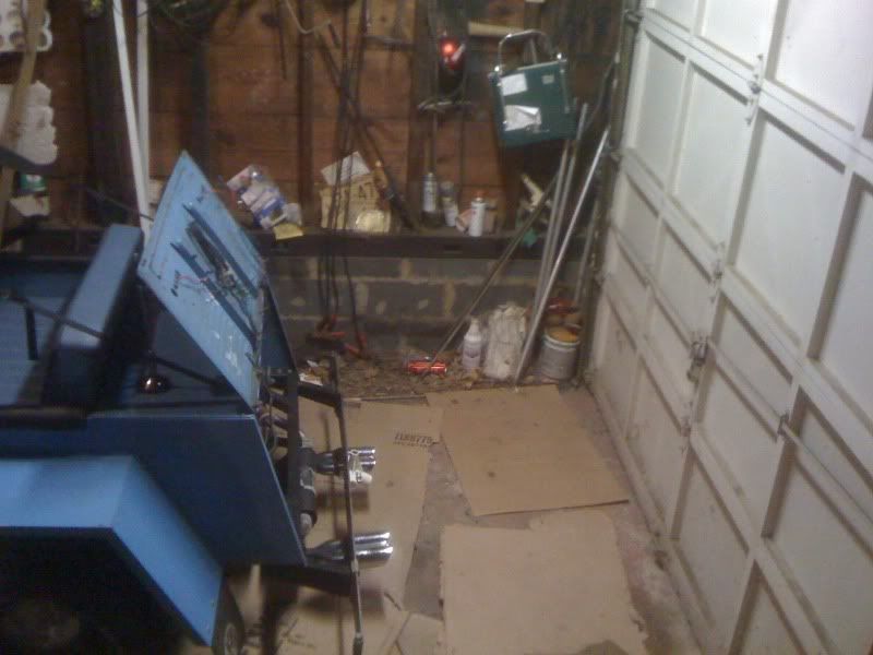

I moved the buggy to the cooler garage instead of the Hot as Hell Barn. ::fire::
Do you think this is enough room I hope so?

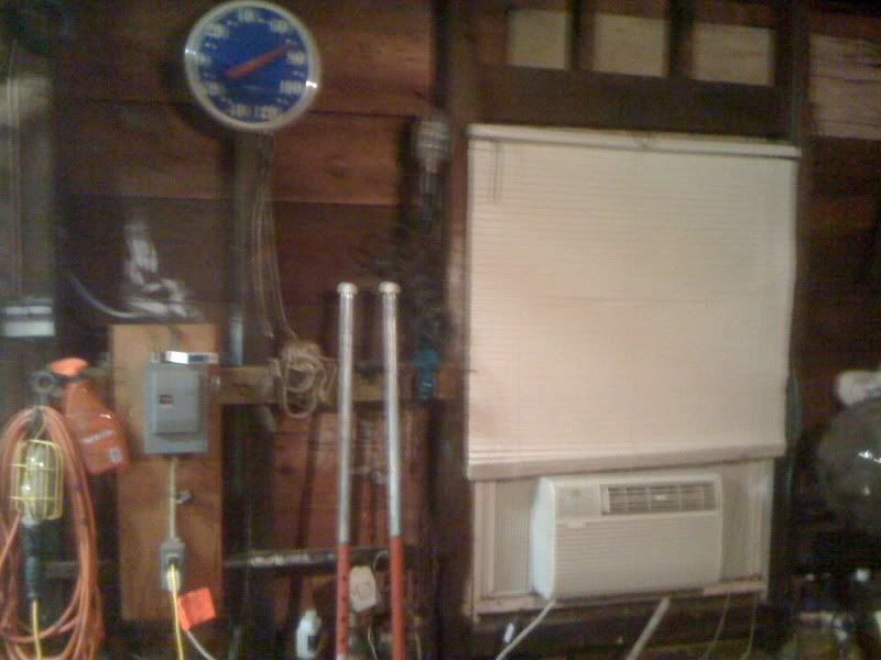

Put a Room air conditioner in the window hope it makes it through the night. It has been sitting on it's side for
I will check the temp in the morning.
Anyone who wants to stop by is welcome.

Thats enough room.

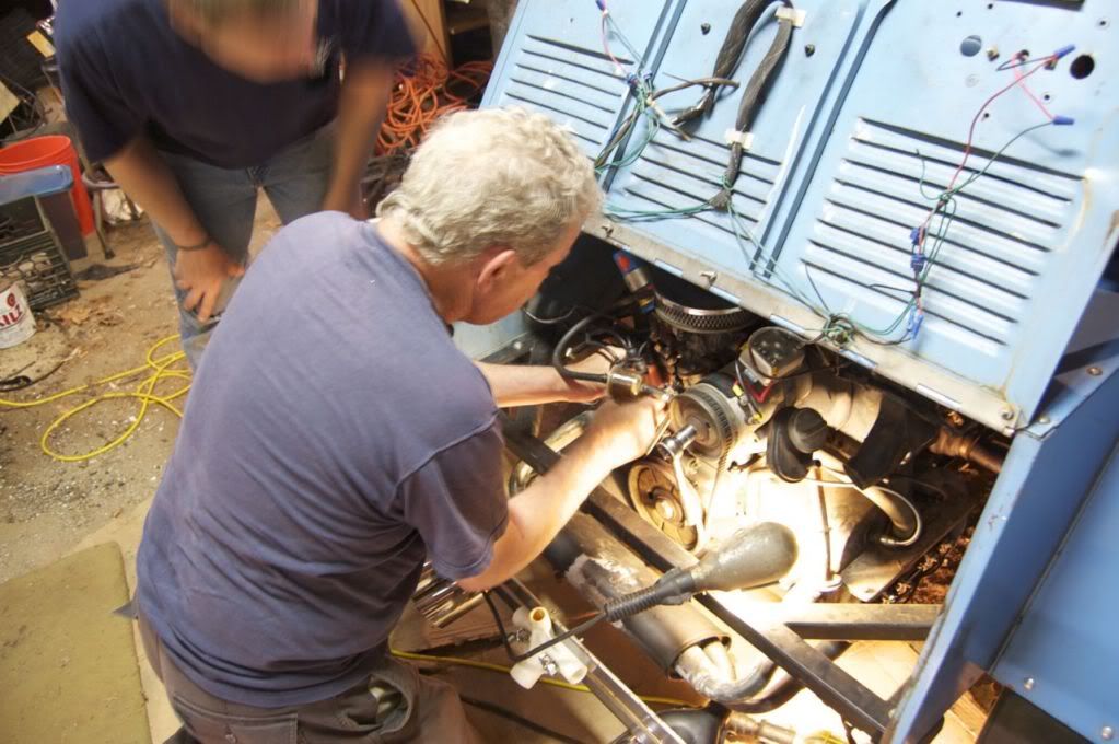

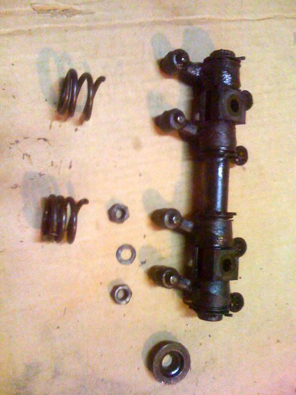

Thanks, Beetleboi -Greg-and JackWagen For Coming over to look at the Buggy.  It is hot as hell even with the Air conditioner running.  It's was 100o out side, But a cool inside temp of
I thought I floated a Valve.   Well I did in a way.  #3 valve was not moving because the spring Snapped.
The valve moves freely and dose not seam to be bent. **^bana0
Jack says he has a tool to put a new Spring in with out pulling the head.  Going to work on it one Monday.  2@@cool

« Reply #1133 on: June 09, 2011, 08:10:59 pm »
Anytime Glenn, glad I got at least one shot in. Jack is quick at diagnosing a problem! He should've been a doctor!
 2@@cool
« Reply #1134 on: June 09, 2011, 08:20:19 pm »
I have the tool to hook the compressor to the cylinder to keep the valve from dropping in.
Just be careful when installing a spring without taking the head off. You could apply air to the cylinder with the car in reverse and have it roll back onto your pantleg and trap you there fo a few hours until your wife comes home to free you....
I'm just saying that's what could happen  whistleegi
