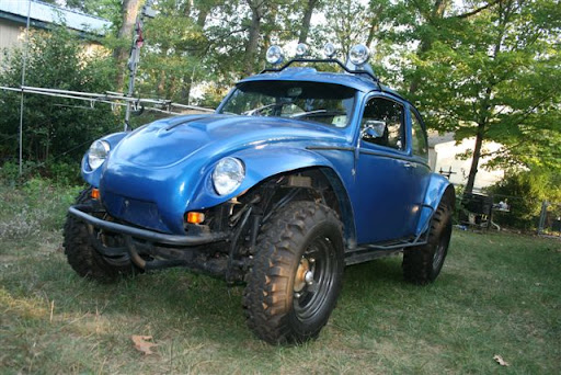

my name is rich.
thats how he set up the boxes. he used the bugzilla kit but has it like backwards. i have it all apart now trying to find a better way.
Welcome Rich.
I've read about the Bugzyla setup but never actually seen one. I'm not so sure it's done wrong...It just looks like it was moved forward to shorten travel (Why I couldn't guess)
Those reduction boxes 'll make that car a mountain goat. More for climbing than flat out speed. Theres a lot of weight out there & I hear wheel hop is a b!*@h, but everybody who runs it loves it.

Re: Newb with a '67 baja from deptford
« Reply #16 on: August 18, 2010, 09:40:00 am »
Now I see it... It looks like he's got long travel adjustable spring plates on there. They might have screwed up the geometry if he bolted it to the "factory" holes
« Reply #17 on: August 18, 2010, 01:58:41 pm »
It looks like the axles would be way out of line if they were moved back to the other bolt holes and that would be havoc on the fulcrum plates.
67baja
« Reply #18 on: August 18, 2010, 04:12:03 pm »
the axle was too far forward the old way and the adapters were upside down. i fliped it and used the original bolt holes and everything lines up great except the factory shock mounts wont work. my guess is the guy did all that to keep the shock mounts. i am just going to make my own
