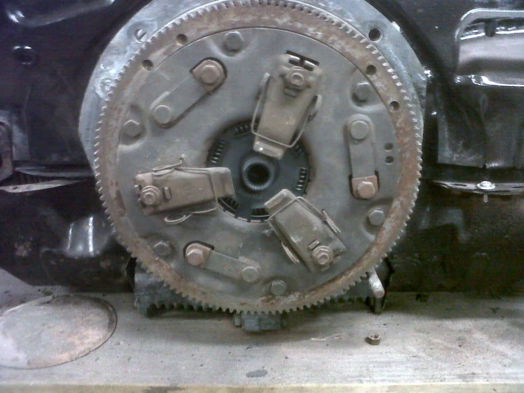

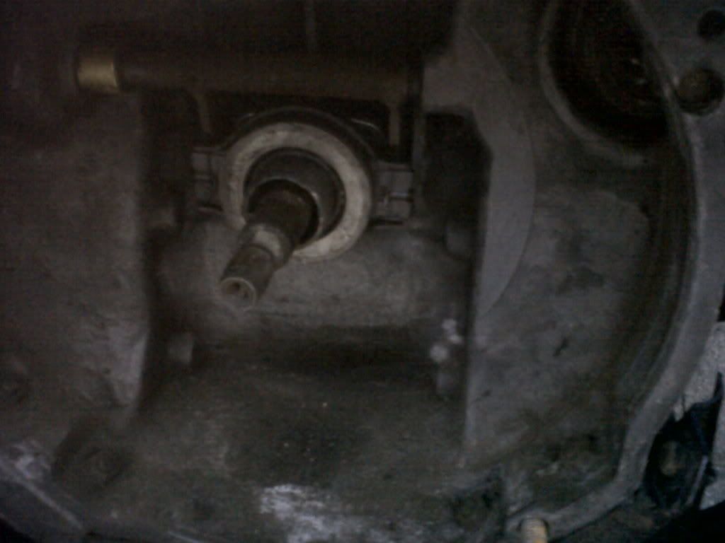

so the motor for the vert has this weird pressure plate on the back for the clutch. are there different bearings in the trans for different plates??? i can post pics of what i have.  :confused04:;

There are two plates it can take and the trans has two cross shafts and T/O bearings, depending on the year you have, you have to match the plate to the T/O bearing.
I think 71 and up don't have a throw-out bearing collar

 You're bug is a 71? - super beetle with flat windshield....?
Re: trans
« Reply #3 on: May 09, 2011, 10:39:06 pm »
yes 71 super flat window. so this is what i gott
Re: trans
« Reply #4 on: May 10, 2011, 09:28:14 pm »
Anyone know if this is right???

Havent seen one of those in a long time!
 I thought 71's had the diaphragm clutch, so I check Clymers, says..... "coil-spring clutch for 61-70, diaphragm spring clutch ( since 1971)"
    from the Haynes Manual ?
"All Volkswagens with a manual transaxle use a single dry-plate, coil spring clutch (1972 and earlier models) or a diaphragm spring clutch (1973 and later models."
some 71 beetles can be considered 70 - but if what you have worked for you, use the same. Just match it up - fi you can't...
you can go here and look at a list of plates
 http://www.wolfsburgwest.com/wolfsburg_new/transmissions/clutch_cover.cfm
I would take the one for your year, -thought my 71 had what was listed here, but that was a long time ago...
and here for release bearing...   again get your year...   http://www.wolfsburgwest.com/wolfsburg_new/transmissions/to_bearing.cfm
Make sure you have a clutch alignment tool when you replace!!
