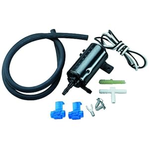

I ordered this today:
http://www.cbperformance.com/catalog.asp?ProductID=1280
and I'll post pics of the install under the Repairs other section . thumpup)-

Where are you going to put it Mugman?

it fits right below the brake fluid reservoir and attaches on a fender nut. Washer tube goes to nozzle and wiring goes to a hot lead on the fuse box to a switch in the dash ( i'll use where cig lighter would go) .Hope Shawn or Jackwagen knows which fuse is hot. Ground to the ground point where speedo lights go to.

Hmmmm. I'm hoping the dang thing fits a Super Beetle since the upper mounts for the struts might mess up the install  :confused04:;
And I noticed the 12v one is out of stock..
KV, they are both 12V. Researching on the Samba tells me it doesnt fit in a Super Beetle on the inner fender. I'll attach it   somewhere else. **read9

Why are we not just putting a $10 pump in the line and re-routing a hose?   :confused04:;
