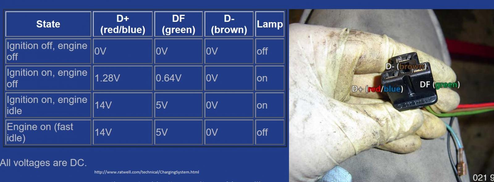

Here is Ratwells voltage reg check
From my blue wire I have a black wire connected to it.
Found with the key on I get a voltage reading at the  D+ plug ( blue/red) of less than 1 volt. If I disconnect the black wire I get 12 volts
This black wire  ( which can be disconnected) goes from the plug into a sheath toward the battery then up, up across the hatch and down the inside of the left hatch to a battery aux relay.
( In this same sheath,  also noticed a red wire going from the NEG battery post to the same relay)
 my wire situation.
I just dont get why I would be getting my alt light on (and EGR) - the only thing I did to the alternator was to move it to remove and install the belt  so as to check for endplay when engine was out
Comparing to this schematic ( as it should be)
I see big discrepancy in that I have a black wire going from my neg pos on main battery, should be off the postive. PO made this setup.
