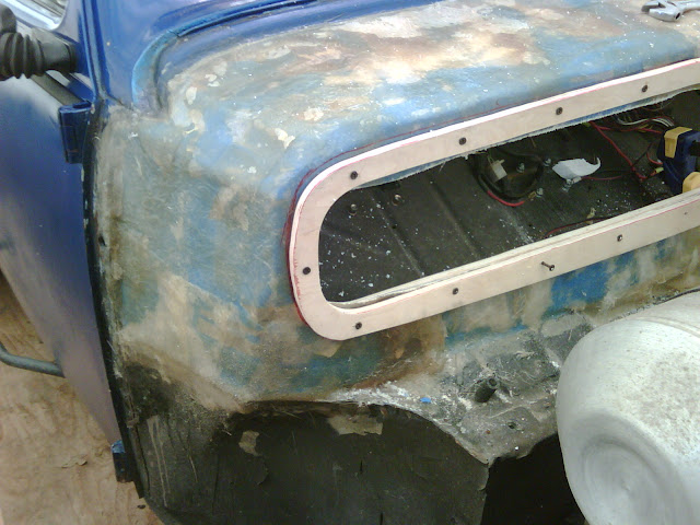

Installed the hatch in the fiberglass under the flip front. Gotta smooth it out now
Looks great, cool idea :icon_thumleft:
