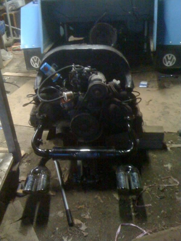

Installed the tire bracket on the front I don't have to cuddle with the tire at night. Still need to put the artwork on the tire cover! SJVWCC  whistleegi

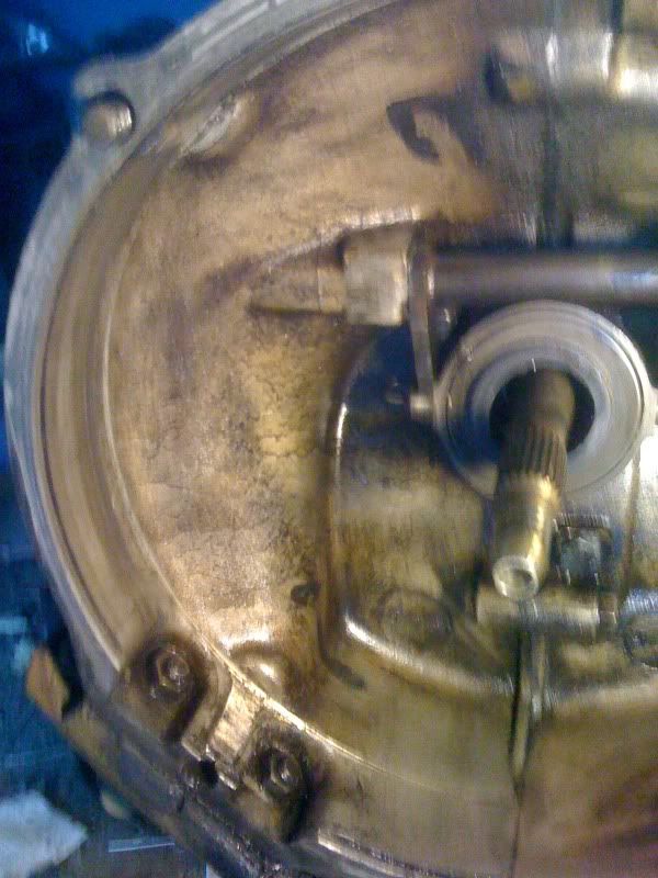

Found out that the Split trany was indexed for the 180mm flywheel only. @%soapbox
I had a hell of a time trying to get the motor in by Myself.

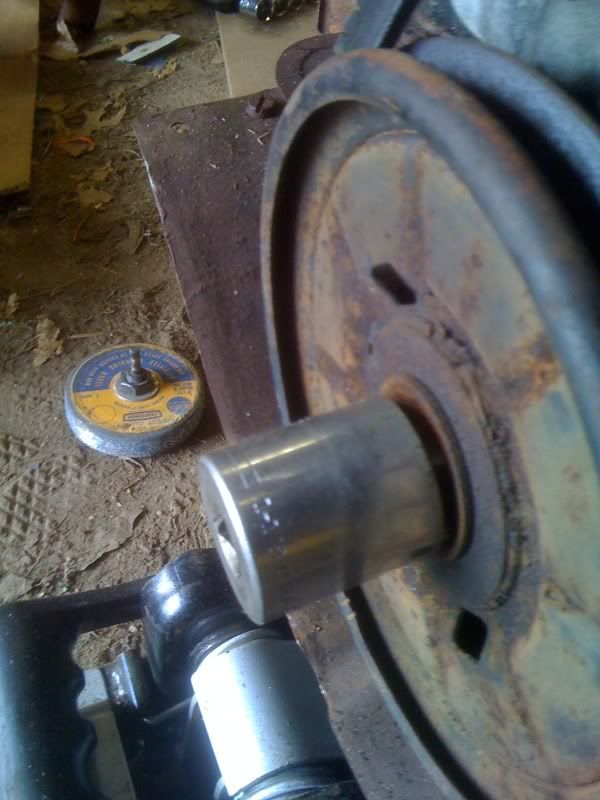

I did a very stupid thing by Hammering a 1 1/8 scoket on the crank bolt it was the only thing I had that was Close.
All that is left is the horn and some fuel line and hooking up the voltreg and coil.

Now I'm woundering if I should have changed out the throw out bearing?
This is the new pressure plate I put in. Will these work together? :confused04:;
 &(rage_ Pulled the Motor once again and have to wait for a new Pressure Plate. bawlin)0
